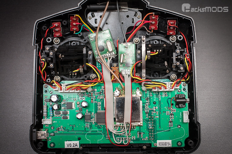

blitz 2 247 Posté(e) 19 mars 2017 Normalement, seul le firmware suffit. Envoyé depuis mon Honor 5X Récupérer sur le site Deviation => Major features include: Support for multiple protocols without any modifications to the transmitter: Walkera DEVO Walkera WK2401/WK2601/WK2801 Nine Eagles J6 Pro (requires telemetry module) DSM2/DSMX Support for other protocols with very easy transmitter modifications: Flysky/Turnigy 9X Hubsan-X4 Skyartec (thanks to the Skyartec folks for providing hardware for testing) Hisky Tactic SLT/Anylink V202 Syma Cheerson ...and more! Pour la modification : Necessary Tools Transceiver module (A7105, CC2500, NRF24L01, CYRF6936, or 'Universal Module') Small Phillips-head screwdriver Solder-sucker or solder wick (strongly recommended) hack-saw (optional) wire-cutters fine-gauge wire (30AWG ‘wire-wrap’ wire recommended) wire-wrap tool (optional) fine-tip (<30W) soldering-iron (NOT a soldering gun) electronics solder soldering flux (recommended) Module Installation Follow the table and images on the Module List page to determine the necessary connections for your modules. See the Image below for the relevant connection points on the Devo7e: Pins MISO, MOSI, and SCK connect to the CYRF6936 Module. Pins 3.3V(VDD), GND, and CSN connect to the debug header. (you can choose to use the GND pin on the CYRF6936 module instead. Either one will work) If one module is being installed, CSN should connect to the 'TMS' pin. If two modules are being installed,one module should connect to the 'TMS' pin, and the other to the 'TCK' pin. If the 'Universal Module' is being installed, 'CSN' should connect to the 'TMS' pin, and 'RESET' should connect to the 'TCK' pin Exemple d'une 7e modifier avec modules A7105 et NRF24L01 => Partager ce message Lien à poster Partager sur d’autres sites
